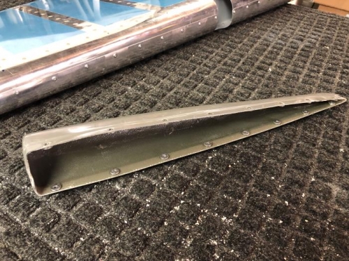

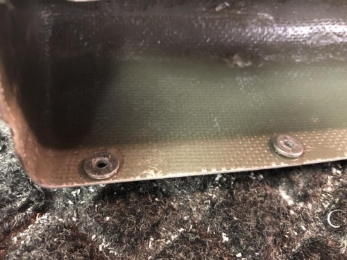

Added rivet washers to rudder tip
After countersinking the fiberglass rudder tip, I decided holes were a bit thin and in need of reinforcement, so I epoxied in 1/8 " aluminum rivet washers for strength.
