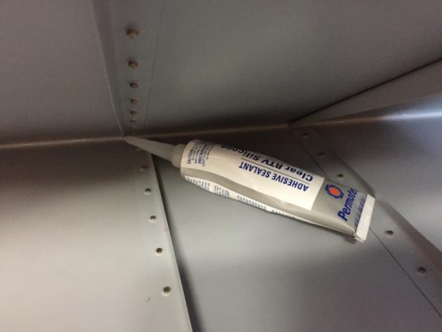

Was still unable to get into the last rivet on the bottom trailing edge. so I used the optional MK-319-BS blind rivet after enlarging the hole as directed to 7/64
Before closing up the skin, I applied the suggested RTV silicon to the trailing edge of the stiffeners.
All done with the rudder except the leading edge roll which I will do later afte reading up on it a bit

RTV applied to trailing edge of stiffeners
