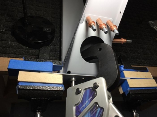

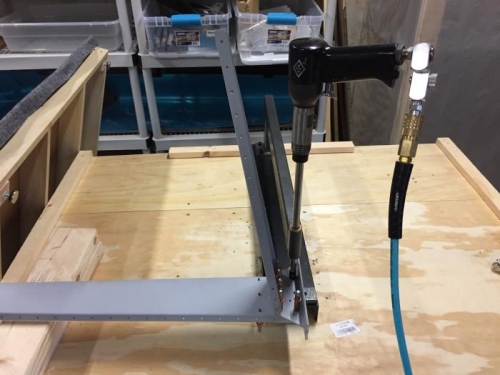

Riveted the Rudder fram together. Was able to use the C-frame to back rivet four wher I could not get the squeezer onto. That setup makes very nice shop heads.
Was able o get the squeeze four at the bottom of the R-405 assembly that had been optional for blind rivets.
Ready to skin it tomorrow and will be done for now with the rudder for now. Going to work on the fairings once I am done with the whole empennage.
Riveting using C-Frame
Able to squeeze rivets on bottom of R-405

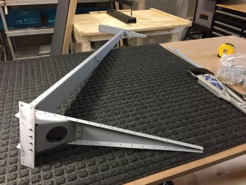

Rudder frame assembled and ready for skin.
