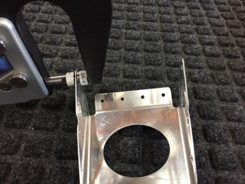

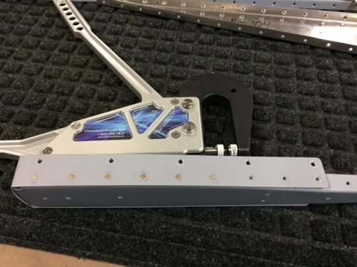

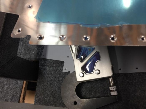

finished CS4-4 dimples. Primed
Yay!, Got the Cleaveland tools CS4-4 dimple die set from the friendly UPS guy today , so I could finish up the rudder frame prep.
Dimpled the R-801PP, R-710, and R-713 #30 holes that needed the 120 degree dimple for the CS4-4 blind rivets.
Prepped and primed R-710 and R-704. Tomorrow when it dries, I'll do final assembly and hopefully get the skin on.
CS-4-4 dimples in R-710 and R704
CS4-4 dimples on skin
