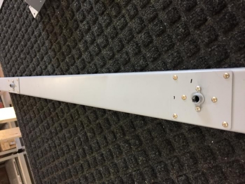

Started riveting rudder frame
Riveted R-713 to R-703 leaving last 3 holes open

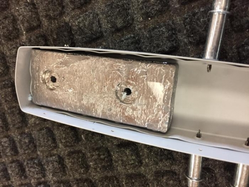

Enlarged 2 holes in R-703 for E-6-1-020 counterweight
Dimpled remainder of R-801 skin holes except the eight that need CS-4-4 dimple. Die should be here tomorrow so that I can finish this up.
R-607PP and R-608PP riveted

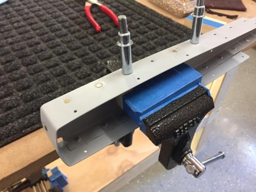

Enlarged R-703 holes to #12
R-713 riveted to R-703
