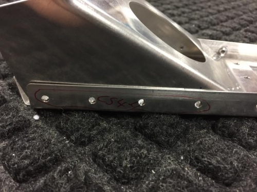

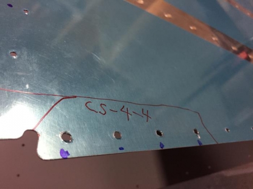

Determined that 4 holes in the R-710 Rudder holn brace were going to need to be blind riveted with CS4-4 rivets. Holes will need to be #30, so I match drilled those on each side.
After reading that the CS-4-4 rivets are 120 degree instead of the usual 100 degree countersink, I realized that I need a new dimple die set, si ordered one as well as a 120 degree countersink made specially for CS4-4 rivets.

CS4-4 rivet holes drilled to #30
skin CS4-4 rivet holes drilled to #30
