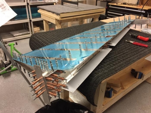

Built rudder and match drilled.to skin
Clecod frame together and match drilled all #30 holes in spar.
Fit R-703 rib to spar and atttched R-713 counterbalance skin.and match drilled.
Match drilled R-710 R-405D and R-740 to spar.
Clecod on skin and match drilled to frame.
Attached R-717 rudder bottom attach strips to assembly and match drilled.

Skin match drilled
R-717 strip added
