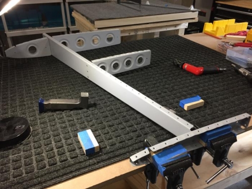

Assembled front spar and ribs.

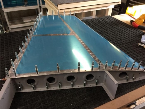

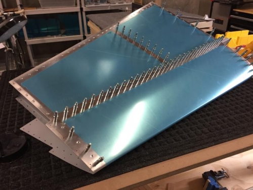

Clecoed skin onto frame and riveted both sides. Was a had to drill out one flush rivet that did not set into dimple to my satisfaction. I beleive that I had too much pressure on the bucking bar.. It came out just fine after careful drilling and next rivet went in very nice.
Fwd spar reassembled
Clecoed and riveted skin
both skins riveted onto fwd fram
