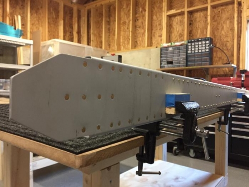

Assembled aft spar in vertical jig and clecod together.
Flush riveted all the bottom rivets first. Was able to backrivet all but the 6 that were up tight against the brackets. Had to drill one out that was sitting a bit pround on one side due to not being properly aligned. Second time was a charm and it sat nice and flush.
Tried a narrow backrivet head on the tight rivets, but bent it over and had to drill it out. Tried hand bucking it using my spiffy little tungsten bar and it went well, so finished up the rest that way.

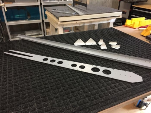

Rear spar parts ready

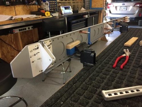

Assembling in jig with clecos
All riveted together
