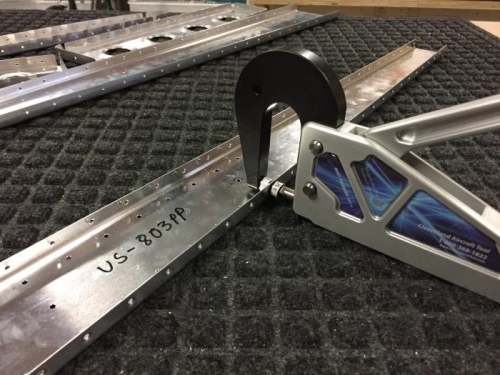

The 3/32' subframe dimple set finally arrived, so I was able to dimple all the sVS spars and ribs.
The subframe dimple set makes a slightly bigger hole that the skin dimples fit into..
Finished scuffing up everything and got them ready to prime.
Primed remaining ribs and spars
using 3/32 subframe dimple set
