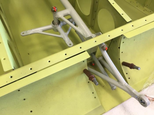

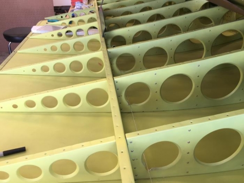

I installed the correct bolt for the aileron bellcrank. The kit already has holes drilled in the ribs for the aileron cable run so I installed snap bushings in the holes and ran a sting to check cable clearance. I needed to trim a little more from 3 ribs for clearance. I left two stings in the aileron cable run to pull the cable later. The second one is a backup in case I screw up the first one :-)

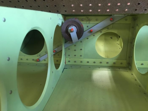

Next I rechecked the toque on the hardware I have already set then put torque seal on the nuts. Then I installed the aileron cable pulley and wing strut attach bars and torque set them. Before installing the pulley bracket I secured the pulley guide with a 6-32 screw.

Bellcrank and Aileron Hinge Set
Needs Just a Little Trimming
Pulley and Wing Strut Attach Set
