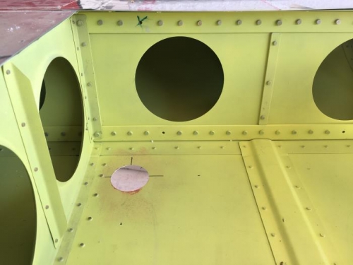

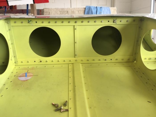

I started the installation of the fuel tank. I positioned the tank using to locate the filler neck. Then I used a 2” hole saw to cut a hole for the location of the filler neck. It’s always a bit nerve racking cutting the hole in the upper skin.

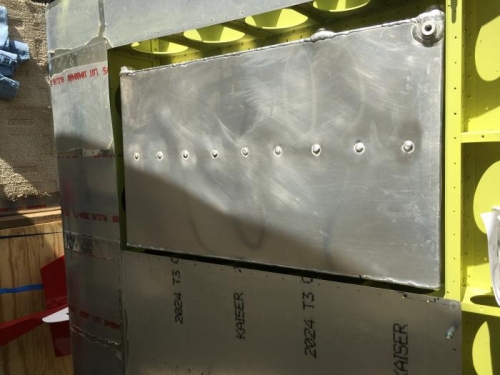

Next was to drill and ream the AN3 holes in the spars for the fuel straps. I ran into a head scratching moment when it seemed to me that the locations without rivets for the straps were wrong. I sent a photo to Mark and he right away confirmed that the early kits had been mismarked. Since I have an early kit mine is affected. No big deal I just had to drill out the rivets in the correct location then rivet the other holes. I was able to rivet 3 of the 4 holes with AD5-8 rivets. It’s a little difficult to get to the leading edge side of the spar so one hole I reamed for an AN3 bolt. It would have been acceptable to use AN3 bolts for all 4 holes but I wanted to rivet them if I could. For the rear spar I had to relocate 2 holes. That was a lot easier because it was more accessible and the smaller rivets were easy to set with the rivet squeezer.
Positioning Tank
Positioning Tank
Filler Neck Hole Cut
Main Spar Strap Location Corrected
