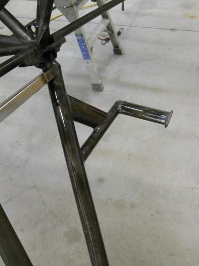

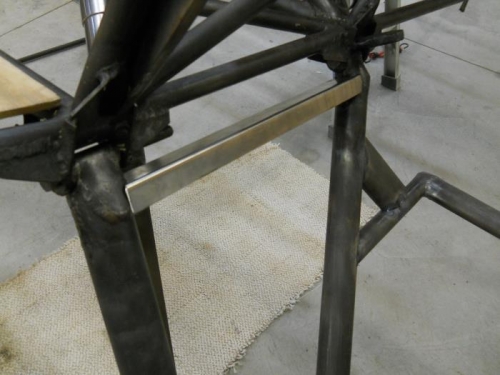

I cut and fit the streamline tube for the step support. Before I finished welding the step I made the .032 channel for the top of the landing gear and welded it on. Last thing I did was remove the gear leg and finish weld the step.

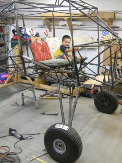

My test pilot came over today to get a little stick time :-)
