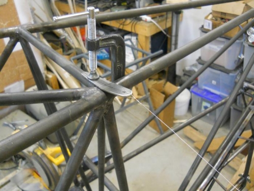

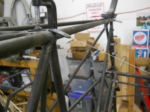

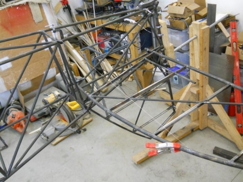

Brief Description:  Weld horz stab attach
I attached the stingers and put the fuselage back in the rotisserie so I could flip the fuselage over and weld the horizontal stab attach brackets on. To set the correct alignment I ran a length of fine wire between the attach bracket and attach point on the stab.
Aligning Strut Attach
Tacked and Bent
Tacked and Bent
