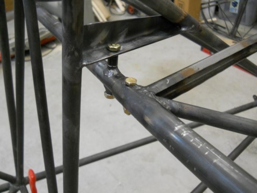

First thing I did today was grind off 1/8" of the inboard of the horizontal stab aft tube on both right and left stabs. Actual it worked well to just grind a matching angle to the aft mount which resulted in moving the stab inboard 1/8" on each side. That resulted in the distance between the leading edge tubes to be 12.75 inches and the aft 3.0 inches per the plans.

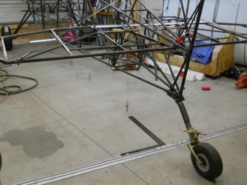

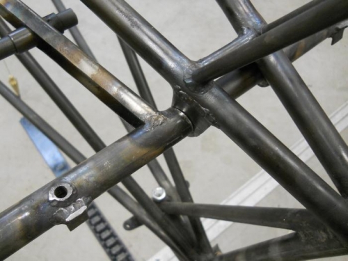

After thinking about it since yesterday I came up with a plan to square up the horizontal stab. I hung several plumb bobs from the center line of the fuselage and drew a line on the floor down centerline. Then using a level I made a mark on the floor that was plumb below the inboard of the aft of the stab. Then I drew a line full length of the aft of the stab on the floor that was square off the centerline using that mark as a reference. Then I just had to plumb up from that line to the outboard end of the right and left stab to square up. With the stab level and square I drilled the hole for a 3/16" bolt on the inboard side of the horizontal stab leading edge tube and secured with a bolt.
I decided not to drill out the hole for the bottom tail wire attach points for now. I may still drill these out later but I want to follow up more. For now I just made a couple bushing out of 1/4 x .028 and used a 3/16" bolt to secure to the bottom attach point. I bent the lower tail wire attach bracket back to the correct angle and attached the bottom tail wire to the horizontal stab.
Aft Tube Fit to Aft Mount
Squaring Up Horizontal Stabilizer
Leading Edge Tube Bolted Secure
