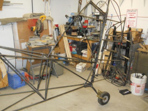

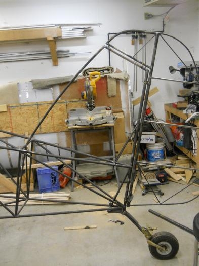

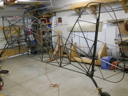

Still catching up on "farm chores" but I did get a little Bearhawk time in this week. I finished up the vertical stabilizer. After welding the top T25 rib and the leading edge tube in place it took me a little time tweaking it to line up correctly as outlined in the manual and the CD. I had it line up before I welded it but it moved. After welding the remaining ribs and diagonal tube it all lines up great without further tweaking.
Top T25 Rib and Leading Edge Tube Welded in Place
Finished Stab
Finished Stab
Another View
Another View
