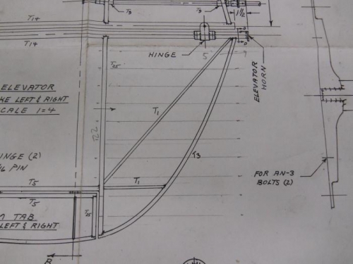

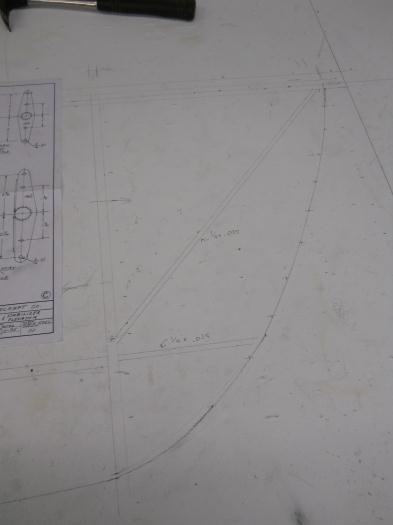

I spent a couple hours laying out the elevator. The outboard is pretty easy to layout because of the reference "X" point to draw the forward and aft arc. I was having a hard time shaping the inboard so after several attempts that just didn't look right I drew some grid lines on the plans for reference. That gave me a good point of transfer every 2 inches. Looks correct now...
Grid Lines on Plans
Grid Lines on Plans
Transfer Points
Transfer Points

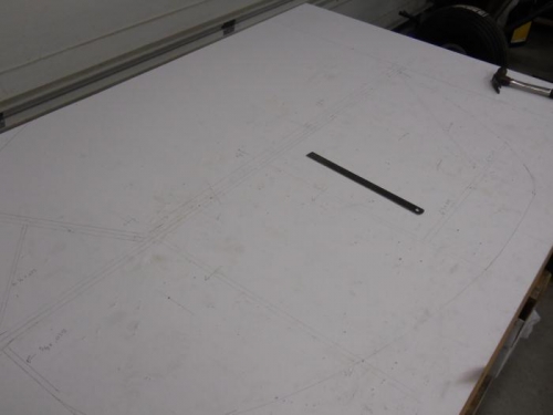

Elevator Layed Out
Elevator Layed Out
