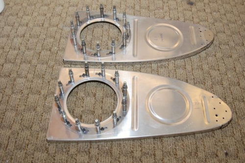

Opend up access holes in root ribs
Drilled and riveted access plate stiffener and nutplates.

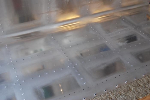

Scuffed and cleaned inside skins and stiffeners with maroon scotchbrite pads and naptha.

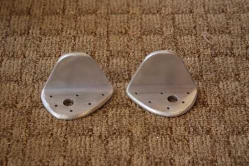

Drilled root ribs for flop tube fittings, vent, and BNC for fuel senders.
Drilling support brackets for flop tubes
Access plates stiffeners mid install
Scuffed up interfaces
