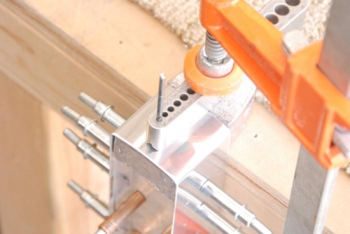

Began the left elevator assembly. Drilled the lead counterbalance weights. Lubrication during drilling is absolutely required, as the lead is soft and sticky. The drill bit really wants to grab. Not having a drill press, I used a drill guide clamped to the tip rib .. worked very well.

Drilling the pilot hole in the lead counterbalance

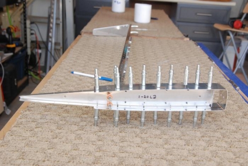

Skeleton coming together
