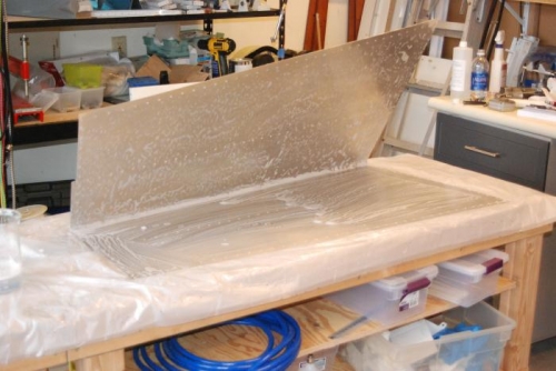

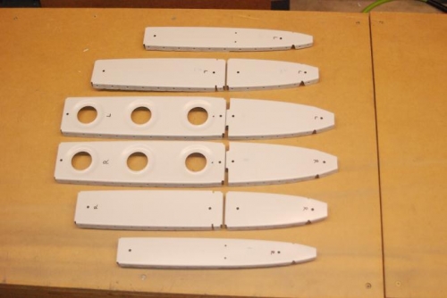

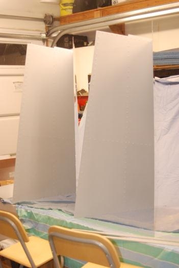

Scrubbed the spars and inside of the skins with a maroon SB pad and EcoEtch … about 5 mins each and then rinsed. Primed the inside of the skins and spar channels with AFS primer, thinned a bit to about 20 sec M50, 15 PSI at the gun. Found that a few light passes are best, otherwise the primer is too thick and runs down vertical surfaces and dries in a ridge or bump. Be sure to let the primer dry at least 12 hours before flipping, othwise you risk the primer sticking to the supports. Patience pays off here.
Cleaning the skins
Cleaning the skins
Primed ribs
Primed ribs
Happy HS skins -- primed and ready
