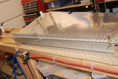

Brief Description:  Gluing the trailing edge wedge

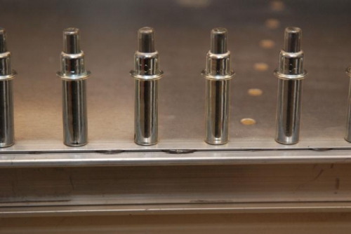

Drilled a 1" x 1" aluminium angle to match the rudder trailing edge. Found that it was not exactly straight. Addded straightedge (4' x 4") to the angle to straighten it; worked great. Mixed up the ProSeal and applied pea-sized dots between the dimples/holes with a syringe (as well as a good amount where the stiffeners come together near the wedge) and clecod the whole thing together. A little oozed out but not much. Let the whole thing harden overnight. The samples of the ProSeal were well cured by the next evening.
All the happy clecos keeping the edge straight
A litte bit of ProSeal ooze-out
