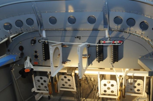

Brief Description:  Power and ground wiring I
Began the installation of the four 8x fuse blocks on the sub panel; the sub panel is dedicated to power distribution. Ran the feed from the master relay to the fuse panel

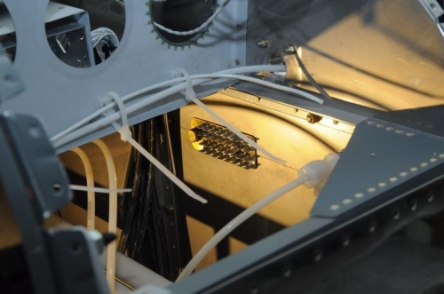

Installed the "forest of tabs" on the inner firewall and fabricated a jumper from the battery to give it an excellent low impedance ground.
Starting to install fuse blocks

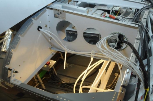

FF wiring bundle
FF wiring bundle
forest of tabs, inner firewall.
