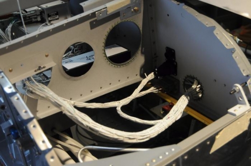

Cut and terminated the 5 cable bundles that go the panel and the two that go to the sub-panel that come from the avionics pallet. Laced the cables so that they are neat and tidy.
Added an adel clamp bracket to secure the big bundle where it leaves the avionics tray through the hole in the rig.
Cable runs from the tray to panel and subpanel

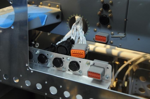

Working end of the panel connectors (with an early bracket prototype)
