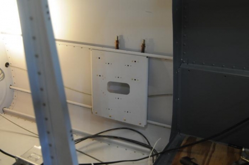

Brief Description:  GPS20A bracket install
Redrilled a Van's ELT bracket for the GPS20A, to be mounted on the left side of tailcone. Primed and added platenuts, and installed in the fuse.
I found for the ELT that pop riveting the bottom edge was nearly impossible, so for this install, I cut off the bottom edge and used a piano hinge instead. This made mouning much easier.
Bracket in place with clecos
