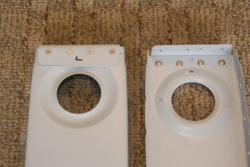

SB 14-01-31 Horizontal Stab 3
Modified HS405 ribs: removed the flang and fit the new angle in its place

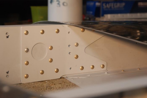

Riveted the reinforcement plates to the spar, and then to the HS405 ribs.

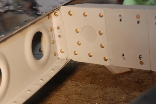

Riveted the ribs back to the skins with a squeezeer. SB complete!
Modified HS-405's
Reinforcement plates in place
All closed up .. back to storage
