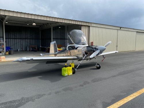

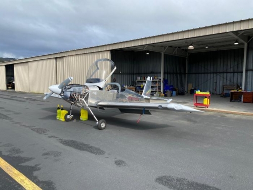

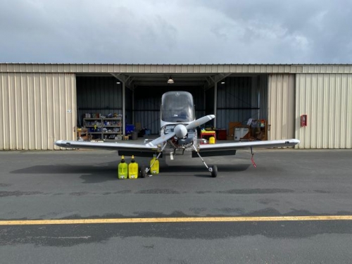

Brief Description:  Fuel tank flushing
Got 10 gallons of 100LL and proceeded to fill and drain each wing 3 times. Fill, cap, shake, drain through filter, both right and left sides. A ground wire was inserted into each jug and was clipped to the airframe for static electricity minimization.
The first two flushes did show some small amount of contamination (aluminum dust, fuzz) in the filter, but third flush was clean.
Tanks showed no leaks or any other issues.
