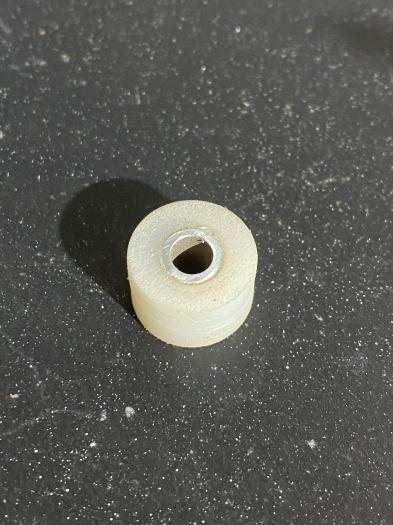

Brief Description:  Aileron stops, clips, fairing
Fabricated aileron stops from 5/8" dia x 1/2" nylon spacer. Drilled center hole to take the existing spacer from the inboard hinge connection on the ailerons, pressed it in and reinstalled. Works perfectly

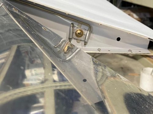

Added retaining clips to the hinge pins for the wingtips.

Aileron stop
Aileron stop
Keepers for tip hinges
