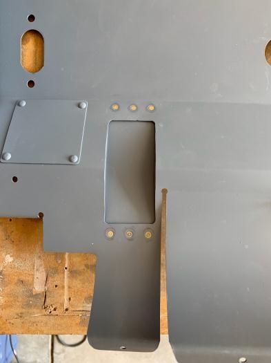

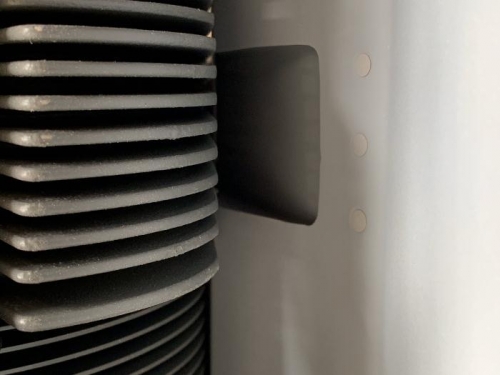

Brief Description:  Add Cyl3 baffle mod
Added the popular Cyl3 baffle mod to provide cooling to the outboard cylinder fins. As designed, no airflow can get under the cylinder with the stock baffle since the fins have zero depth in this area. Typically, a "washer trick" is used, but proper cooling demands actual duct work. A typical mod to Van's stock baffles.
Air channel, inside
Air channel, inside
Air channel, outside
Fin side view
Fin side view
