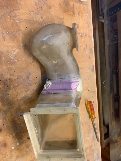

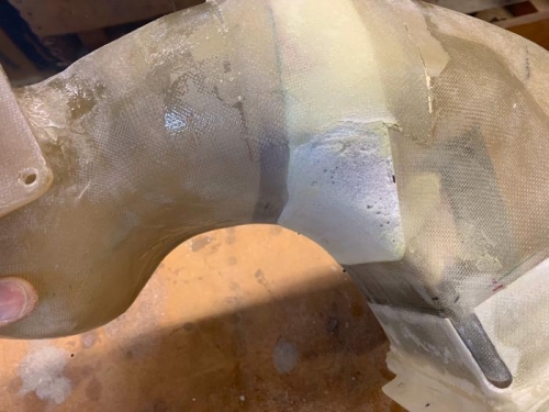

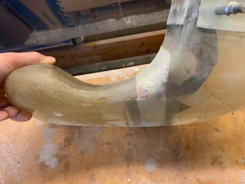

Brief Description:  Complete layup of snorkel mod
Snorkel is off the engine. Trim pink foam, shape, and fill with two part expaning foam (cures hard in minutes). Shape sand. lay up 3 layers of fiberglass over cut area and let cure. When done and cured, melt out foam with acetone, and sand inside and out.
Inside edge of snorkel, not yet trimmed
Trimmef filled and sanded
Ready to lay up bridge
