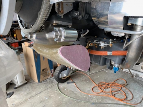

Brief Description:  Shape plug and layup snorkel on engine

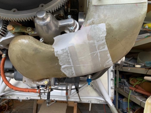

Fit the snorkel to the plane. Add plug material to close the space across the cut, fill with two-part urathane foam, shape and sand. lay up two plies of glass over accessable parts of the snorkel. Inside edge, below starter, is not accessable and will be done later, off the plane
Inserting plugs in snorkel
trimmed and sanded
trimmed and sanded
layup curing
layup curing
