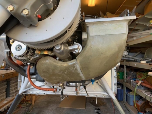

Rework snorkel for fit to baffle deck

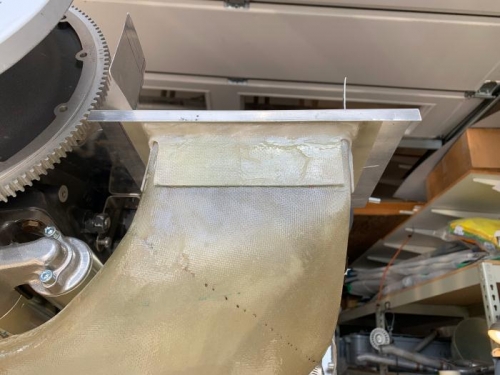

Rework snorkel for fit to baffle. Meaure rough offset required, cut the snorkel, replace on plane, mark for final cuts to allow the pieces to be briged (about a 1.5 inch gap).
Measuring needed lateral offset

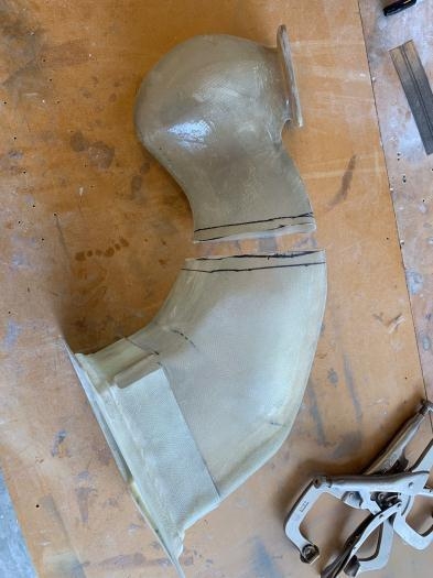

This better work!
Cut snorkel in place for more measurements
