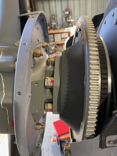

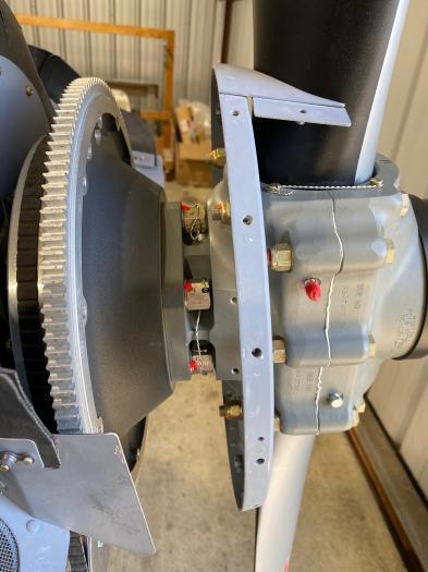

Final install of the propeller on N430WB (RV7 sn 74152)
Hartezell Propeller Inc
HC-C2YR-1BFP / F7479-2 (constant speed)
Mfg: 2/12/2018
Blades: L85584, L85580
Torqued bolts to 65 ft-lbs per Hartzell procedure in Manual 61-00-15 Section G. Safety wired all mounting studs.
Total time in service: 0.0
Total time since overhaul: 0.0
