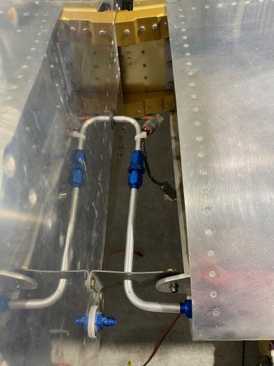

Completed the plumbing lines from the tanks to the fuse.
