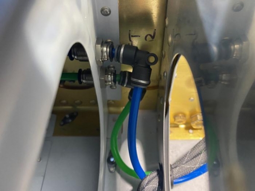

Time to conect the wing systems.
- Finalize pitot routing
- Install flaps and ailerons
- Install and torque wing bolts
- Lay in aileron push tubes
Torque setting for bolts: AC 43-13-1a/2a from 1988
AN4 bolts 50 -70 inch/lbs
AN7 bolts 450-500 in/lbs
NAS 1304 bolts 80-100 in/lbs
NAS 1307 bolts. 520-630 in/lbs
Pitot/AOA connected
Control surfaces on
Pusrods in
