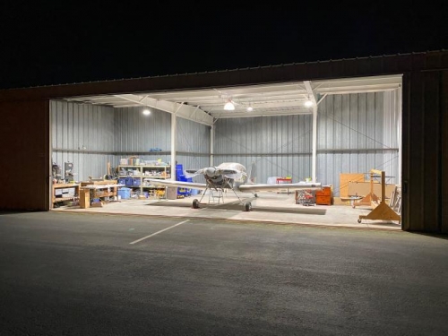

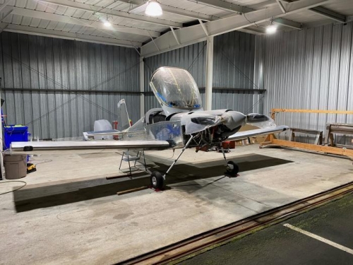

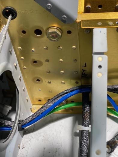

With the help of a fellow RVer Pat, we mounted the wings. Lubed them up a bit with a bit of LPS-1, set them on some saw horses, and wiggled them in place. Used my previously made drift pins to hold them and then inserted two close tolerance bolts each side. The rivet gun with a flush head and the pressure turned down low so that each hit barely made bolt move worked perfectly ... slowly moving the bolt into place and allowed lots of time to watch it come through so be sure it wasn't catching on anyting.
Easy peasy!
Wings on!
Wings on!
Inital two bolts in
Inital two bolts in
