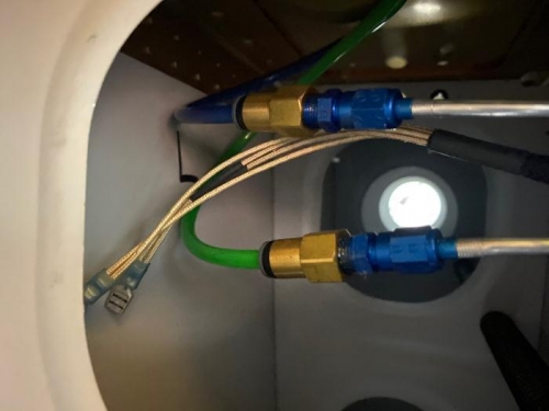

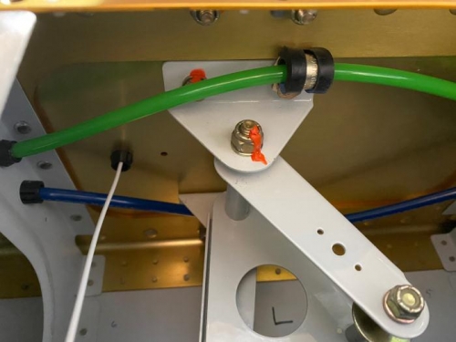

Install pitot and plumbing in the wing. Made a large service loop to route the 1/4" pitot and AOA tubes ... long enough that they can be drawn outside the wing via the mast for maintenance. routed the lines around the left bellcrank bracket to prevent any interference or pinching.

Pitot connection in wing
Tube routing
Tube routing

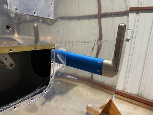

Pitot tube done!
Pitot tube done!
