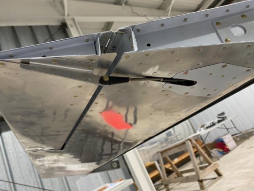

Attach and adjust trim tab
Connect and adjust the trim tab. Had to lengten the slot in the elevator to accomodate the full range of motion.
Routed the trim tab wiring, connected it up and confirmed proper operation (nose down / trim tap up; nose up / trim tab down)
Tab connected to actuator
