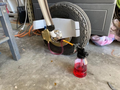

Brief Description:  Bleed brakes
Bled the brakes today with a VAF hint on how to make a cheap but effective bleeder with a pressure oiler. Set up an overflow catcher on the oil resevoir and started to slowly pump. It took about 15 mins a side to fill the brakes, with very few bubbles. Another 5 a side flushed the last bubbles out. The pedals feel nice and HARD!
