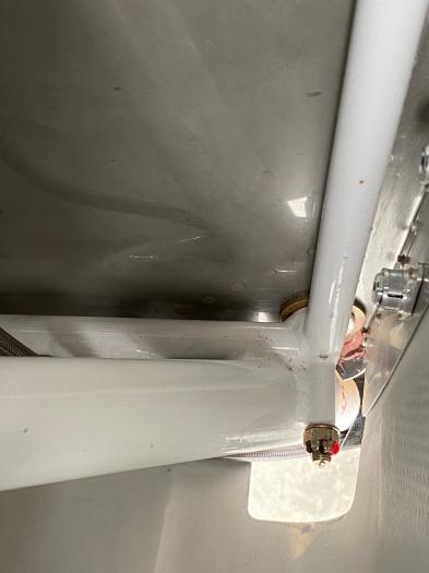

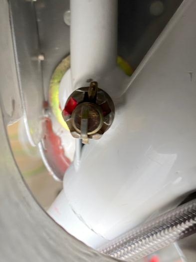

Brief Description:  Add washer under lower engine mount to raise nose
Added a 1/16" washer under lower engine mount lands to rais the nose slightly to align the spinner to the cowl. Alignment significantly better now. Surprisingly easy to do with the engine hoist. Change out one bolt at a time.
