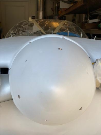

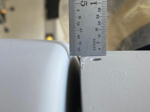

Brief Description:  Fit cowl and measure gaps
After final cowl fit-up, it was found that the spinner is slightly low wrt the top of the cowl. A simple fix commonly used is to shim up the lower end of the motor mount with washers and retorque the bolts. I'll give that a try; 1/16 AN washer will give 1/8" on the front based on the geometry of the engine.

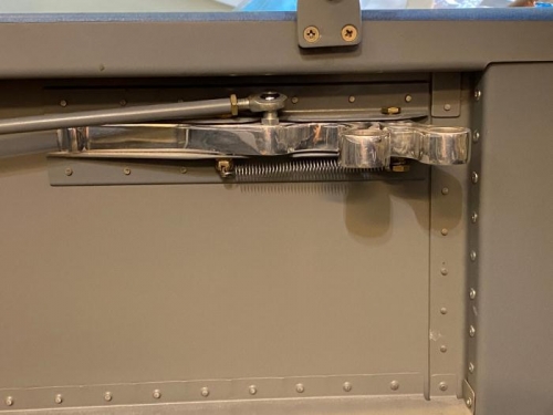

Finalized fit up of the canopy latch.
