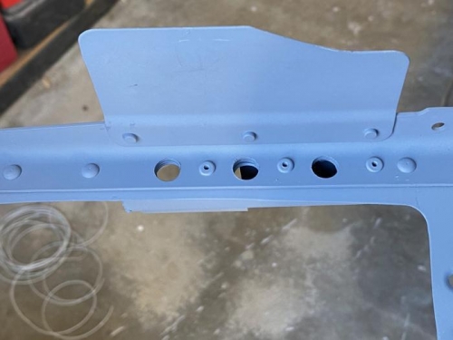

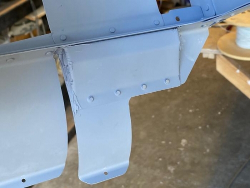

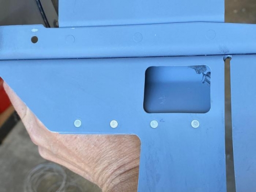

Brief Description:  Cyl 2 baffle mods
It's well documented that because of the baffling design and fin profile, almost no air will get to the bottom outboard baffles that have a airflow wrap. This mod opens some ports behind the air filter and has duct to channel air to this starved area. There is little room here because of the snorkel that attaches just in front.
Air ports
Air ports
mini-duct
mini-duct
Port to lower fins.
Port to lower fins.
