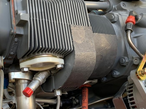

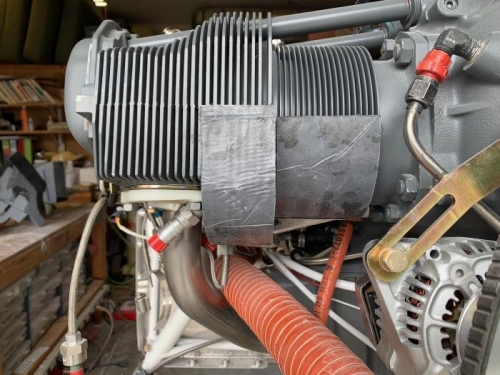

Baffle wraps
Add permatex-impregenated fiberglass sheets under the baffle cylinder wraps that attempt to keep the cooling air against the fins. This keeps the air in against the fins and minimizes leakage; does not require perfectly tight wraps.
Permatex rolled into fiberglass sheet
Wet wraps in place
#1 Cly wraps, cured and trimmed
