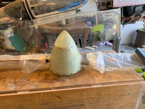

Brief Description:  Fit spinner II

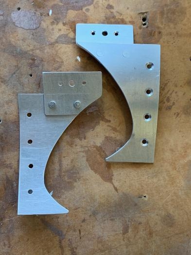

Tested and adjusted the cutouts on the spinner for the CS blades. Fabricated the under-blade backing plates and riveted them the spinner plate. It was challenging task to put a uniform bend in the 0.063" think material so that it would conform to the spinner backing plate curvature.

Spinner in place
Spinner in place
Backing plates between spinner plate and prop
