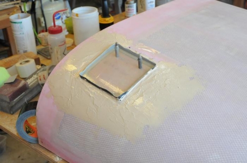

Brief Description:  Fill in rim around oil door
The oil door stands proud of the top of the cowl in its depression .. time to fill the edges. I needed to figure a way to keep the filler from sealing the door in place ... two layers of duct tape around the edges seems ot give a good gap. Let's fill it and give it a try.
Door with duct tape
Door with duct tape "dam"
Filler in place
Filler in place

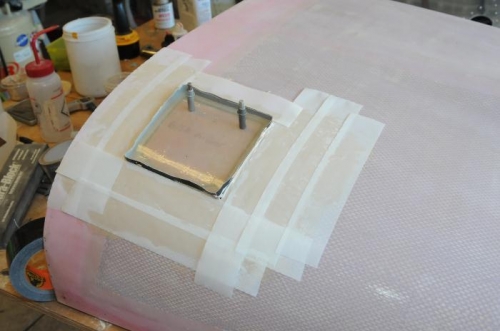

Peel ply to keep runs to a minimum
