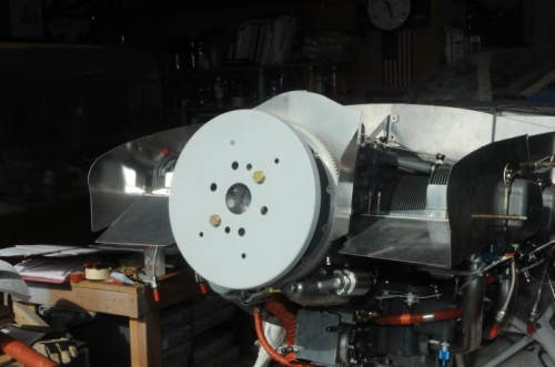

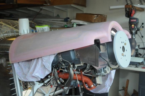

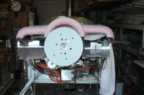

Brief Description:  Cowl fitting 1
Time to start grinding on the cowl! Temporarily installed the spinner plate with some AN7 bolts and washers to get a feel for where the cowl should end up. I used some PVC pipe to simulate the prop hub to the forward spacing corredct, however the side to side slop is enough to convince me to install the prop to do the final fitting. The baffle sided need some serious cutting down.
Spinner plate installed
Side view
Side view
Front view
Front view
