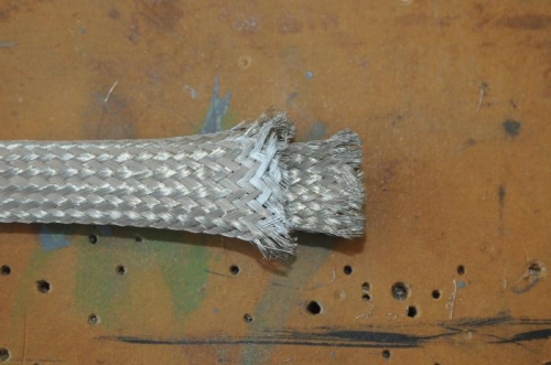

Brief Description:  Fabricate engine ground straps
Used two layers of 0.5 in braid to fabricate the grounding cables fromthe engine to firewall. Crimped on a 8 AWG ring terminal on each end and installed per plans. This strap is suprisingly flexible!
Strap with terminal installed
One strap inside another for strenght and conductivity
