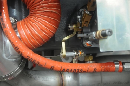

Brief Description:  Modify throttle fitting for clearance

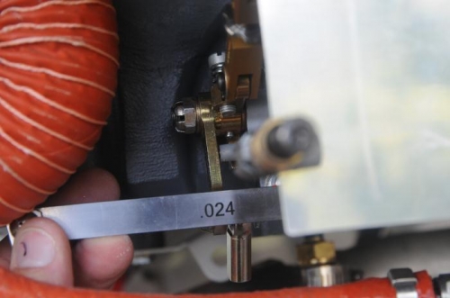

The throttle arm comes quite close to a stop pin in the throttle assembly ... the clearance is 24mils, seems too tight! I ordered a dogleg bracket and modified the assembly to position the rod end mount point correctly. No more clearance issues!
The origial gap can be seen just behind the fuzzy cleco clam in the first picture.
Throttle to pin gap: 0.024
Throttle to pin gap: 0.024"
Alternate implementation; no issues.
