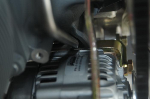

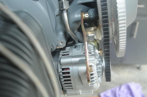

Brief Description:  Initial fit of alternator and fan belt
Installed the alternator brackets and alternator. As a test fit, I installed the flywheel and fan belt supplied with the alternator and found that the belt was a bit short; with the belt in place, the body of the alternator was touching the prop oil line. Clearly, this is not desired. I will order the next size larger belt and check the fit. Fortunately, this is only a $5 fix.
Alternator butting up aginst oil line
Zoom out.
Zoom out.
