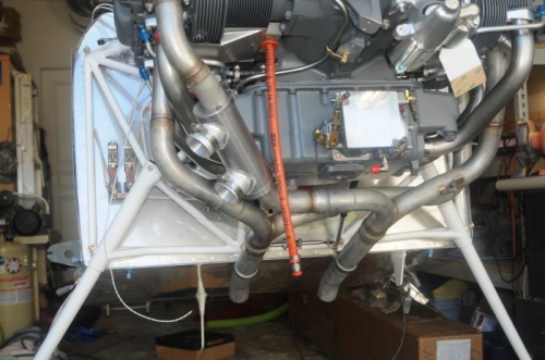

Brief Description:  Install exhaust stack (first time)
Installed the exhaust stack to the freshly mounted engine. Following plans, the exhaust stud bolts were greased with high temp Permatex anti-sieze paste and set up finger tight. Installed the crossover trombones, also with anti-sieze. Used mouse mik on the ball sockets.
Fabricated and installed all hangars and supports for the pipes near the cowl exit.
Freash out of the box
In place with hangars and muff
