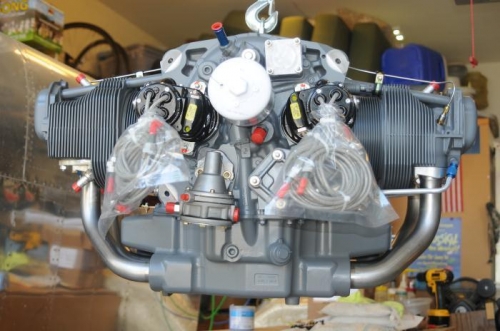

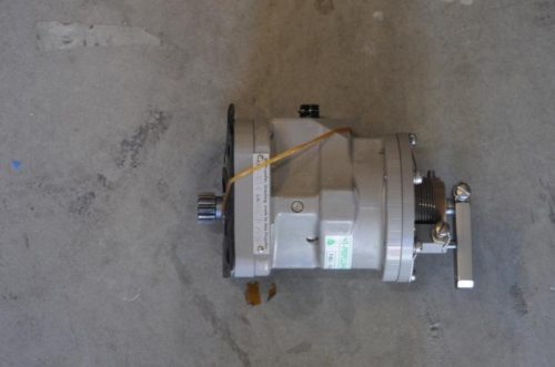

Prepping the engine for install ... the big missing piece is the prop governer. Removed the com er plate and prepped the flane. Installed and torqued the four governor bolts to spec, 180-220 in-lbs
Accessory end of the engine
Prop governer out of the box
